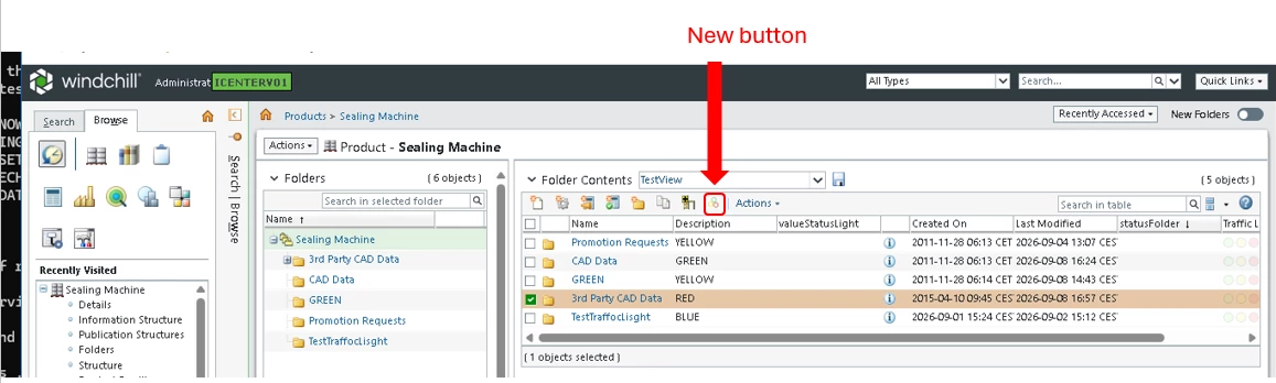

I have winfochill 13.1.4.0 rev 01 and I created a button at the button level in the Contents folder (as shown). By clicking the button, I would like to read the values ​​of the selected row. How can I do this?

You need to register the Form Processor with the custom action in the custom.actions.xml file.
Use the <command> class tag to register the Form Processor by providing the fully qualified Java class path.
<objecttype name="" resourceBundle="">
<action name="">
<command class="test.TestFormProcessor" method="execute"/>
</action>
</objecttype>
In the Form Processor, use the logic provided below.
You can access the selected objects info using the object variable.
