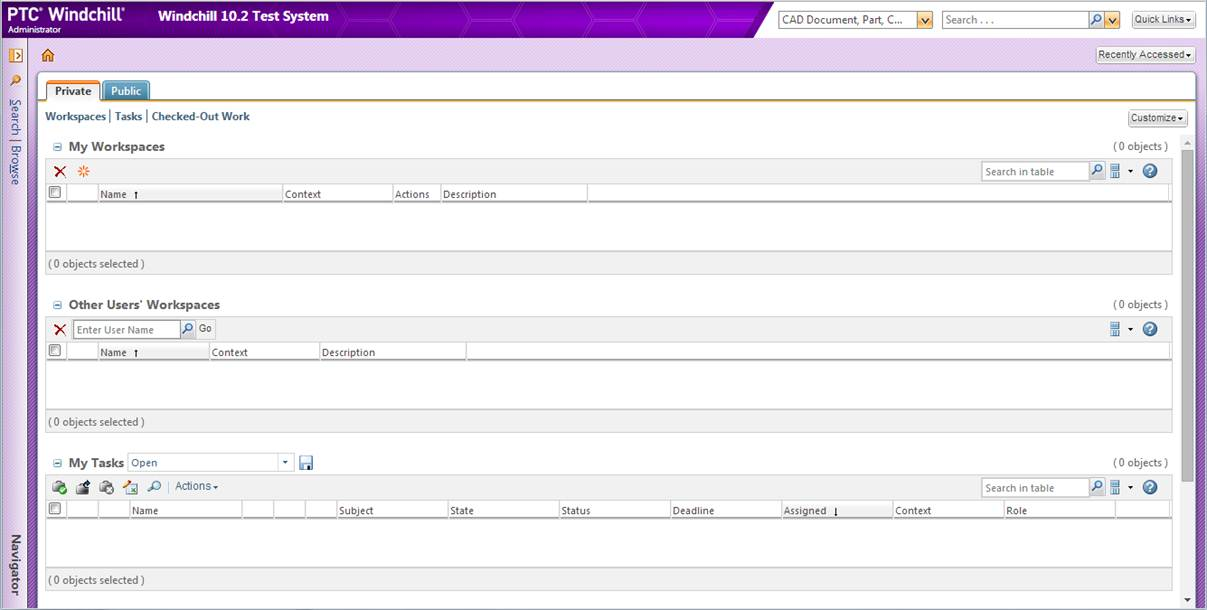

Something else you can do is manually alter the colors in some key files. (You won't find this in the documentation.) Here is a picture of what my test system looks like and the files I changed to get there. (This is for 10.2)
codebase\netmarkets\themes\windchill\Header\
codebase\netmarkets\themes\windchill\navigator\
codebase\netmarkets\themes\windchill\panel\

Hey Tom,
How did you get the "Windchill Test System" to come up? I have looked at the files you posted and they don't pertain to this text on your pic.
Thanks in advance,
