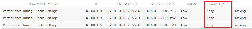

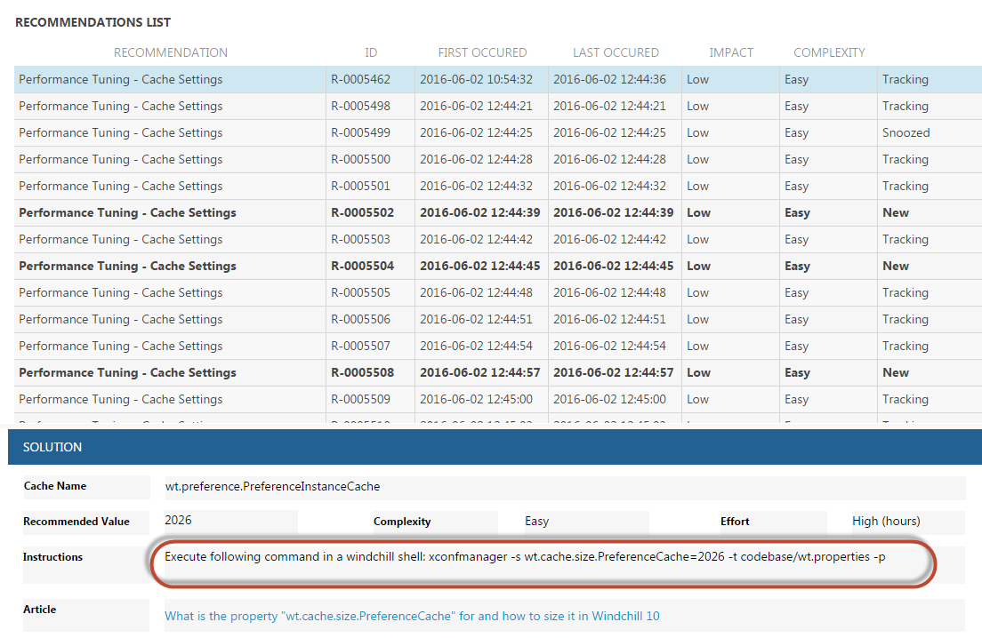

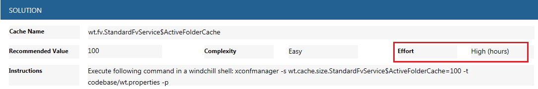

Steve Shaw‌, just tying this out.  Noticing that there seems to be a discrepancy between "Complexity" and "Effort".
There's not much "Effort" involved in entering an xconfmanager command.  Maybe 10 seconds.  Certainly not hours.

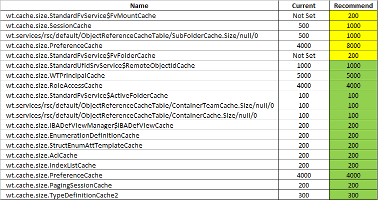

So for one of my test servers there are 19 different recommendations.  14 of the 19 already match the currently set values.  Why are they being recommended if they already match???

Hi Tom,
Starting with Windchill 11.0 M010, recommendations based off Windchill Configuration Assistant (WCA) data will take into account the current set value for the Cache; if they are equal we wont generate a recommendation.
If you opt-in to send Performance Metrics data, then the cache recommendations generated will no longer be based on WCA data, but instead on actual utilization metrics of your system and accordingly we will make a recommendation to re-size the cache. The algorithm calculates the overflow rate of the cache and if the threshold (1/sec over 10 minutes) is exceeded we will make a recommendation based on current cache size:
•if current cache size <5000 increase cache size by 100%
•If current cache size >5000 and <50000 increase cache size by 50%
•if current cache size is >50000 contact technical support
See chart below for additional information
