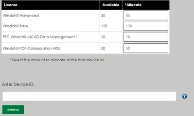

jbailey
18-Opal
Oct 19, 2023 11:54 PM UTC
So Licenses cannot shared between Windchill instances, as each instance is a "Site" where licenses are allocated by system ID. The licensing mechanism is built into the web application. That being said, in the license management portal you can allocate a certain number of each license to a specific host, which would allow you to use that set of licenses so support two production instances on one buy.  So if the company has 200 licenses, and Division A needs 80 and Division B needs 110, then you should be good. Please note, if there are users that need to access both, they need a license for each production instance.
That being said, what is the use case for different instances? You could set up multiple Orgs in the single instance, and each org could have its own policies, administrators, vaulting, attributes, subtypes etc.
The only caveat is things that have to be customized at the site level will affect everyone... Like security labels, UI customizations, Site level policies / preferences etc
