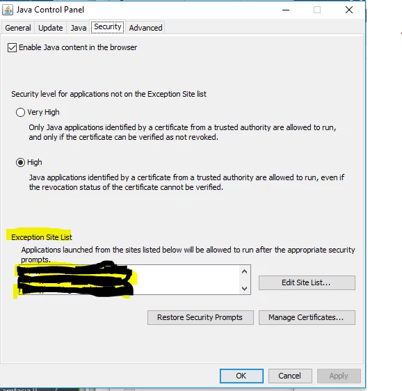

Well, it looks like that solution has only partially correct. It got me through the rehost process and I can login to the rehosted system, but I do not have file vaults nor can I administer them from the browser.
I get this message when I try to open File Administration:
wt.util.WTRemoteException: Unable to invoke remote method: nested exception is:
         wt.util.WTRemoteException: Unable to locate method server, nested exception is:
         wt.util.WTRemoteException: Unable to get server, nested exception is:
         java.security.AccessControlException: access denied ("java.net.SocketPermission" "192.168.xx.xx:5002" "connect, resolve")
Nested exception is: wt.util.WTRemoteException: Unable to invoke remote method
Nested exception is: wt.util.WTRemoteException: Unable to locate method server
Nested exception is: wt.util.WTRemoteException: Unable to get server
Nested exception is:  java.security.AccessControlException: access denied ("java.net.SocketPermission" "192.168.xx.xx:5002" "connect, resolve")
20-Turquoise
September 15, 2017
Have you added your new Windchill server to the "Exception Site List" in the "Security" tab from the Java Control Panel on your local client?security.ong.PNG
BenLoosli23-Emerald IIIAuthor
September 18, 2017
My server is listed as an exception.
