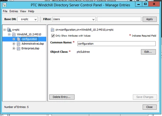

Hi all. I'm currently working on cloning a Windchill PDM Essentials installation using the Rehost Tool. When I run the tool, I'm getting stuck in the LDAP connection with the message shown below. I've read a couple of posts and I've made sure that the WindchillDS credentials are correct as well as the baseDN.
I also checked that WindchillDS is running by connecting to it from another computer using "LDAP Browser/Editor" by Jarek Gawor. I'm using the same information used in the rehost.properties file and I can connect to it and browse its contents. I can also run the ControlPanel file inside of the WindchillDS directory.

Hi all, and thank you for your help. It turned out that the error was on the password I had set. It included a "@" sign, which I guess doesn't work with the Rehost tool. I changed the WindchillDS password to letters and numbers only and it worked.

Please check in your LDAP if you have this below DN if not correct that in the rehost.properties.
target.ldap.baseDn=cn=configuration,cn=Windchill_10.2-M010,o=ptc
Jan 10, 2020 2:06 PM UTC
Hi, this is a screenshot from the Control Panel for WindchillDS:
Jan 10, 2020 1:02 PM UTC
Hi lionelsosa,
Check if it is o=ptc or o="something else".
Have you installed DS separately or copied from source?
If copied from source, Install directory server separately. After installing, import the ldif file try restoring them. By placing your source files from bkp to target bkp folder and then use restore.

Hi. I copied the WindchillDS folder from the source. After I ran the Rehost tool the first time, the DS was up and running without me doing anything. I just had to change the Manager's password in the config file as I didn't have the old password.
Is it better to uninstall the copy and install it fresh with the PTC Solution Installer?
