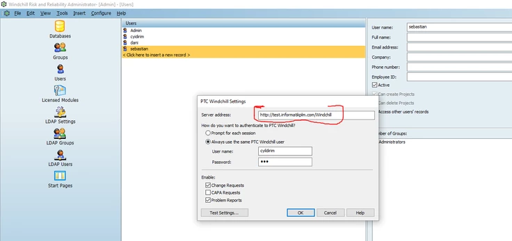

I am rehosting Windchill PDMLink along with Windchill Quality Solutions. Is there any way to rehost Windchill Quality Solutions ? As far as I know, I need to re-install the Windchill Quality Solutions and after that select the option of "restore the existing database". That will create the database instance and then do I need to manually import the .dmp file and then run the Conversion Wizard ?
Please help me out here.

I think what you need to do is, just changing server adress of Windchill from admin panel after rehosting Windchill.
If it does not work, re-import the integration files from info engine > task delegate admistration
