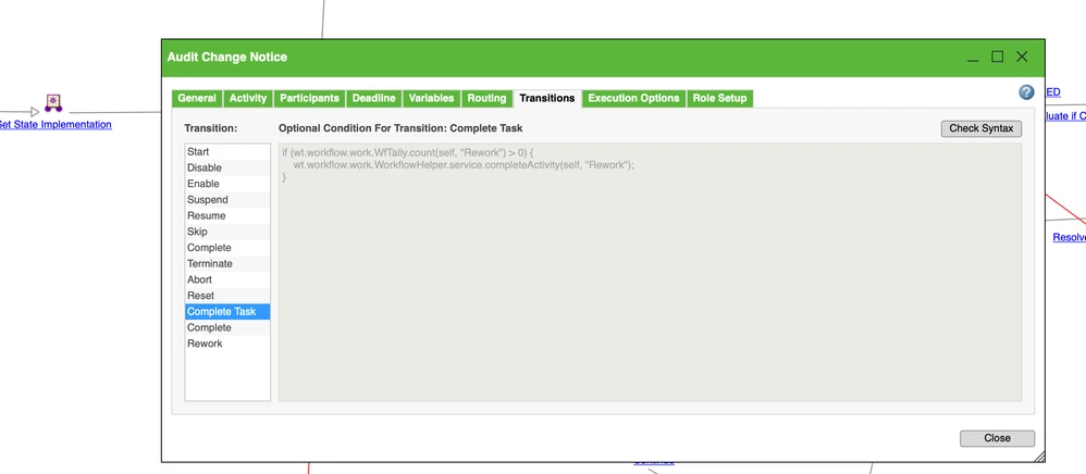

Jun 9, 2021 7:59 PM UTC
Just for anyone which searches for this topic. This solution is out of date. Since Windchill 11.0 there is a workflow task transition called "Complete Task". This code will start the rework as soon one of the Change Admins votes for rework.
if (wt.workflow.work.WfTally.count(self, "Rework") > 0) {
 wt.workflow.work.WorkflowHelper.service.completeActivity(self, "Rework");
