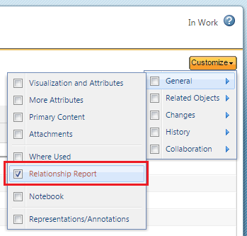

Not sure about Intralink, but in Windchill (10.2) it's located here:

Hi Tom,
Thanks for the reply you've answered by question. At first I couldn't tell from your screenshot what page you were on to get the Customize button until I finally tried the "New Tab" button and there it was.
