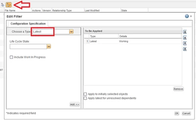

If the filter is set to 'Latest' (the default value), the latest version of each dependent object will be displayed.  This is from 12.1.
I no longer have access to a 11.0 system, but this does not appear to be configurable.
https://www.ptc.com/en/support/article/cs17849

I agree that if the filter is applied to latest, latest version of each object is displayed.
Same 'Latest' filter is applied in 11.0 for Relationship Repot table, still the behavior is different there. It shows incorrect version of drawing object. Please refer above attached document/video for refernce.

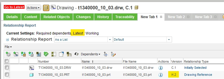

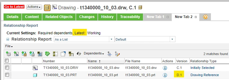

TomU
Nov 2, 2022 4:22 PM UTC
I fired up an old 11.0 system from backup and I can confirm this issue does not occur in 11.0 M030 CPS04 or 12.1.1.2.  Both are showing the same thing as your 11.1 system.  I wonder if this problem is specific to CPS16.
11.0 M030 CPS04
12.1.1.2

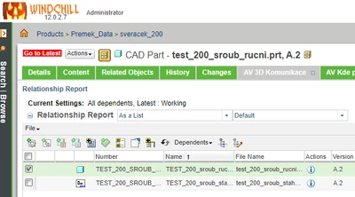

HelesicPetr
Nov 2, 2022 7:23 AM UTC
Hi @SY_10256354
It seams that it is a bug and the bug was fixed in a next version.
I tested the behavior in a version Wch 12.0.2.7 and behavior is as expected in the wch 11.0.
The report shows correct version for previous revision...
PetrH

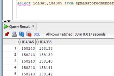

Nov 2, 2022 6:56 PM UTC
Just looked at this in some detail.
Are you able to examine the database?  This relationship is key and may give some clues:

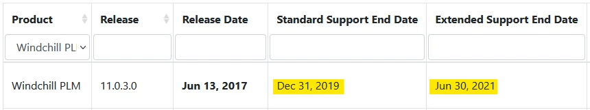

Nov 2, 2022 5:43 PM UTC
Another question that should probably be asked is why would your client move to 11.0 M030.  It's very old and not even supported any more.
