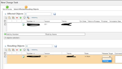

While creating a change task, I have to manually set the release target for the resulting object to Change:
Is it possible to set it to Change by default

Yes, set the preference "Multiple Release Targets" to no in a preference management
Edit: I found that it is complicated 😄
you need to follow this article:CS121968

also there is new preference that can be set
Change Management/Select the Change Transitions for Release Target
ChgMgmtReleaseTargetConfiguring
