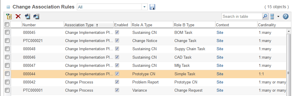

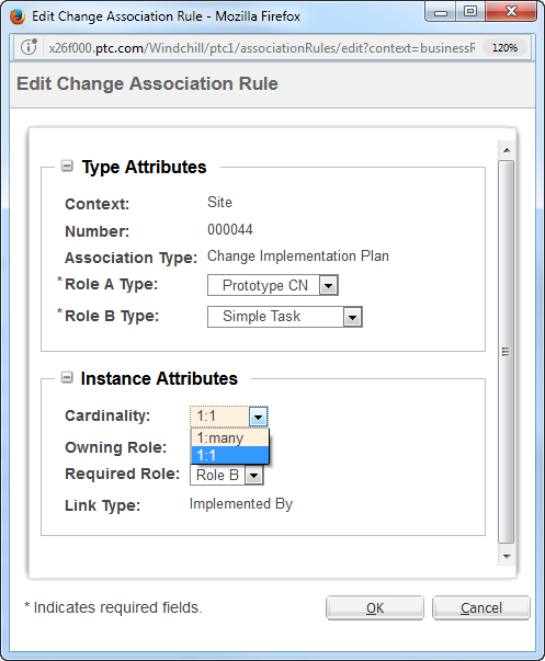

Jun 7, 2017 2:36 PM UTC
You would define a rule so that your type of Change Notice gets your Change task.  This is defined on the Business Rules page in the Site Utilities page.  The Change Association Rules table lets you define what Change Tasks should be related to which Change Notices types.
You can see in this example the Sustaining CN type can have Supply Chain Task, CAD Task, Mfg Task and BOM Task related as 1:many.  The Prototype CN can have a Simple Task related and is 1:1.  By default the CR will propagate data to the default task (and if you use Relationship constraints should only give the the right objects to the task - say WTPart to the BOM Task and EPMDoc to the CAD Task)
For example if you have myChangeNotice with myChangeTask related on a 1:many.  By default you will get at least 1 myChangeTask and could create additional.
