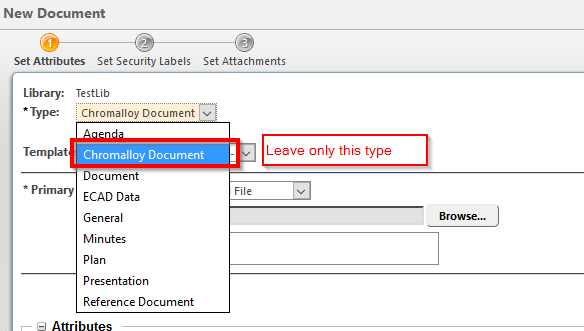

Remove default document type enumerations from New Document dialog.
How can I remove default document type enumerations from the drop down list in the Create new Document dialog? We only want to have document soft type that we created.
Thanks!

Nov 30, 2016 5:15 PM UTC
For each type that you do not want to be created at all, from Type and Attribute manager uncheck Instantiable
OPTION: In each context, for each type that you do not want created in that context, create an OIR for that type, with a lifecycle specified that does not exist.

Alex_P1-VisitorAuthor
Nov 30, 2016 5:30 PM UTC
Thank you so much for such a fast response! The setting of "Instantiable" attribute helped...
