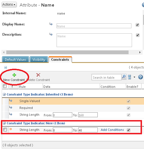

Hi Guys,
I want to remove the OOTB String Length constraint for the Document Type (actually I would need that the maximum length accepted to be on 40 char instead of 160). Is this possible?
How can it be done?
Alex
Jun 22, 2016 12:27 PM UTC
you can add new string length constraint to limit name to 40 chars
shreyas
ailut1-VisitorAuthor
Jun 22, 2016 12:32 PM UTC
Hi Shreyas,
That is true and valid when you give the name yourself. The problem appears when you add a primary content source with the name larger than 40 char. Windchill will accept the name even if you set the constraint to 40 char.
Alex
Jun 22, 2016 12:45 PM UTC
Do you want to restrict fileName/Primary content name to <40 chars ?
Shreyas
