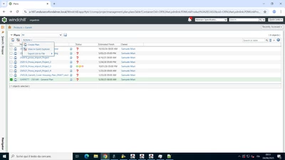

Hello, i'd like to remove Plans from Product -> Plans -> Plan
I have not possibility to delete.
How can i do it?

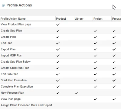

I think this can be done with Profiles:
You can assign users to a Profile that removes these options.

I'm logged in as Administrator, but i can't.
If you also see in your screen, delete is no available.

You have to assign the people you want to disable (not delete) the plan page for, then edit the profile to uncheck the "View Product Plan" page.
