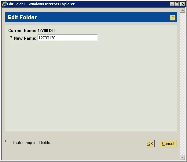

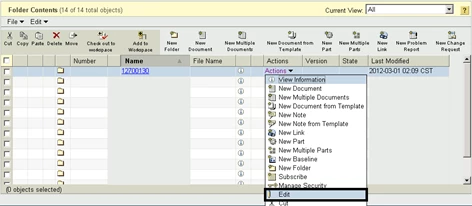

David,
On a folder, click on Actions --> Edit to rename a folder. Let me know if
it works.
[image: Inline image 1]
[image: Inline image 2]

Mar 11, 2015 6:52 PM UTC
Product view of folders, select actions->edit or the checkbox next to
folder and select edit at table top. If hidden, check permission level and
settings. Generally a bad idea to give everyone this capability as security
options exist within.

davehaigh13-AquamarineAuthor
Mar 11, 2015 7:04 PM UTC
Thanks, that’s the ticket.
