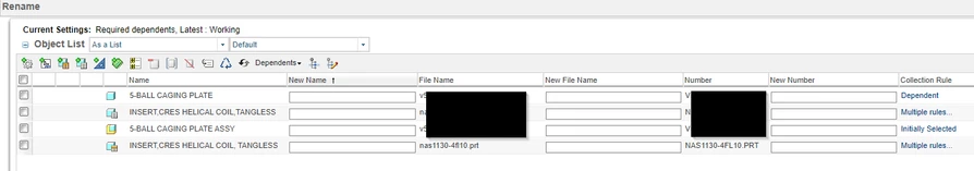

Hi Everyone,
I have 100 components in a single assembly, I want to rename all the components like number, name & filename. Can we use the export from the spreadsheet for this? Actually, I tried to change the filename on this method, but I can't change the name & number. Can you help me with how we can do this?

avillanueva
23-Emerald II
Jul 3, 2023 2:06 PM UTC
This is standard OOTB functionality. If you rename a CAD assembly, you can use the collector to get its dependent models and rename, renumber or change filenames of them all in one shot.
Jul 4, 2023 4:04 AM UTC
Hi Mr. Avill,
Thanks for the replay.
                 I import all the details using the import from spreadsheet method, there I can change the filename(Common name), I want to do the same thing for numbers and names. I tested on here if I change the name or number in WT Part it's created with a new number, not updating the latest modified.
Amir
HelesicPetr
Jul 4, 2023 7:44 AM UTC
Hi @Amirtharaj_K
The spreadsheet does not support changing the numbers. Number is unique identification and the spreadsheet do not allow you to define old and new one.
PetrH
