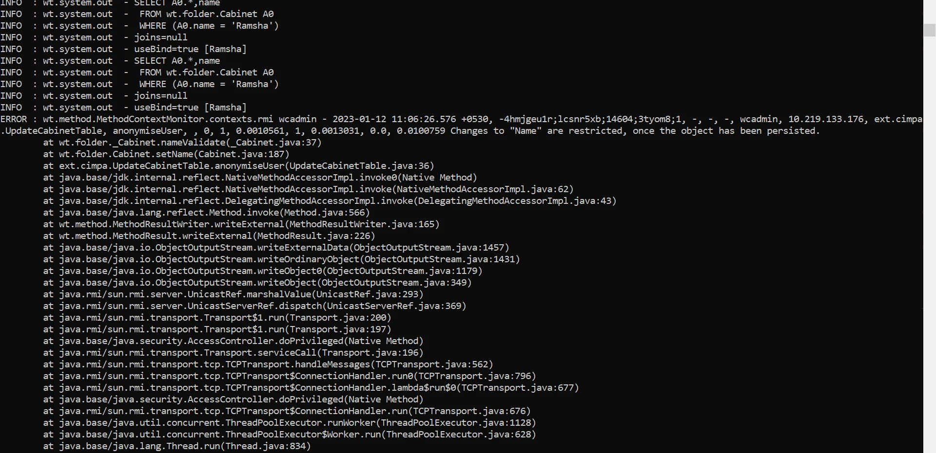

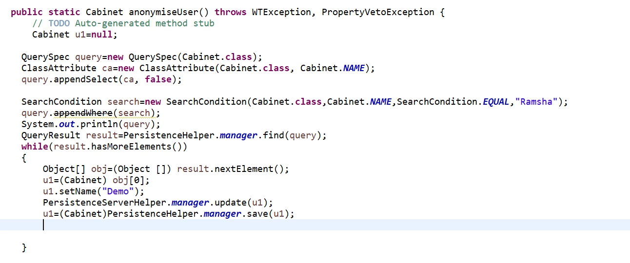

I am trying to rename the "Name" field in Cabinet table using code. However I am facing an error while doing so. Does anyone have any suggestion on how to proceed in this? I am attaching the code snippet and the error that I am facing.
Any help would be highly appreciated.

Hi @RK_10348291
if a object is persisted it is not possible to change a identity directly on the object.
You need to use  IdentityHelper.service.changeIdentity
Example>
		Cabinet cabinetFolder = null; // you need to search for the cabinet , null is just used for demonstration purpose
		CabinetIdentity cabinetIdentity = (CabinetIdentity) cabinetFolder.getIdentificationObject();
		try
			cabinetIdentity.setName("new Name");
		} catch (WTPropertyVetoException e)
			e.printStackTrace();
		try
			IdentityHelper.service.changeIdentity(cabinetFolder, cabinetIdentity);
		} catch (WTException e)

Jan 13, 2023 5:00 AM UTC
Hi @HelesicPetr ,
Thank you for the solution. It works fine now.
