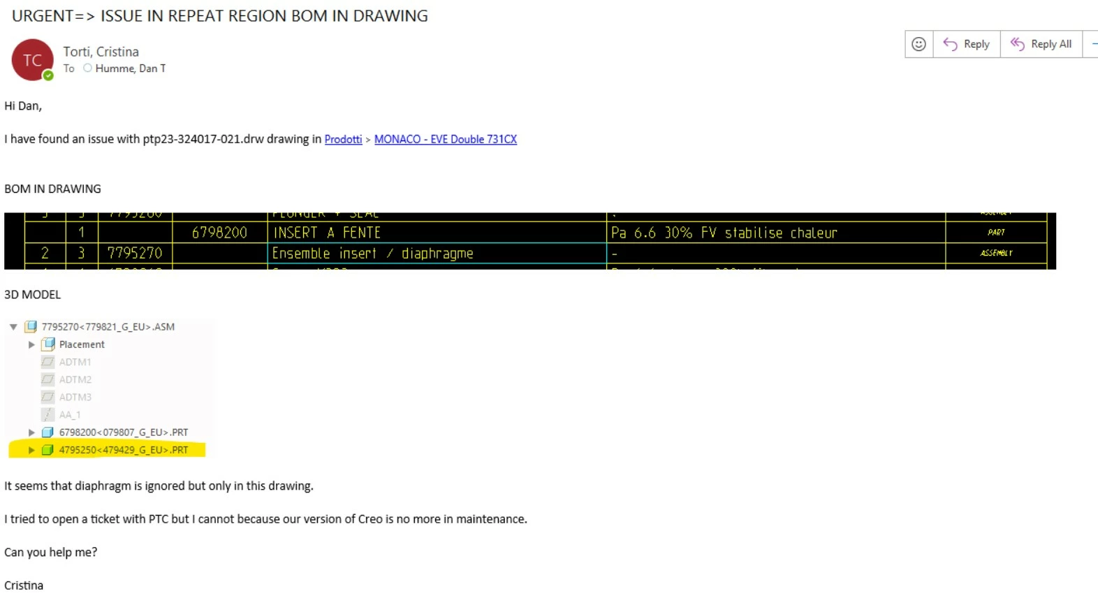

REPEAT REAGION BOM IN DRAWING CHECKED IN RECENTLY HAS ISSUE. ONE COMPONENT OF SUBASSEMBLY IS IGNORED . CREO 4.0 AND WINDCHILL 10.2

I suppose issue could be related to windchill because I have “recently” checkedin the drawing. I could be it is only issue with Creo Parametric. I am opening a drw drawing in Creo Parametric and 3D model is correct but repear region table in drawing is missing one component and no filter in table is on.

You can diagnose this by adding to workspace and looking at "latest" vs "as-stored" for the drawing. Look closely at the iterations of the assembly that its asking for. Do this is a clean and empty workspace. This eliminates any local modifications of the assembly that might appear in your current workspace. Lastly, I do not deal with drawings much but try rebuilding or creating a new repeat region table?
