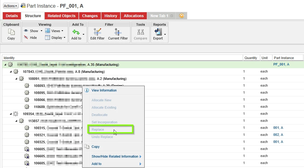

I’m trying to make the “Replace” button active in a structure of a Part alternate:
I can’t understand why it is not active. Looking at the following documentation https://support.ptc.com/help/windchill/r13.1.2.0/en/index.html#page/Windchill_Help_Center/configsandinstances/CIInstanceReplacePartWithin.html I don’t see what is justifying this behavior. I already have an Alternate for the Part I want to replace.
Any ideas?

Thanks for your reply.
The left click is actually coming from one of the child, sorry I should have been more precise about it.
But in the end I think I managed to find a way. For some reason the test I did, by adding an alternate to the the part I want to replace worked.

Version of Windchill used is the 12.0

Looks to me that you are trying to replace the top level of the structure. To me It doesn't make sense to replace something at that level. If you were to replace something it would be at a child level.
