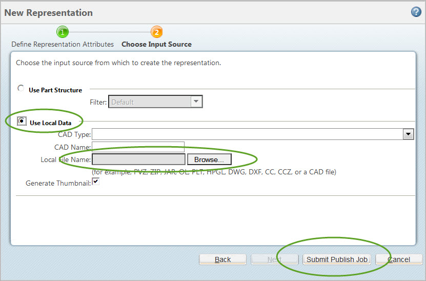

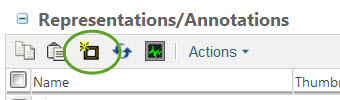

You can manually create a Representation and upload a file (PDF) from disk.  You can set this as Default Representation as well as delete other representations.  Have this in place as a "poor man's publishing" alternative to the Adobe LiveCycle based OFFICEWORKER (which wouldn't publish Visio files anyway).  Another requirement that I'm not sure the LiveCycle based publisher would handle (OOTB at least from what I can see) would be adding the Document Number and Revision into a Footer on the face of PDF.  Yes a Watermark could work but Footer is preferred.

That works for a document, which I have used, but for a drawing, you do not get the Local File Name box to upload an existing file.
I need to replace content of a drawing, not a document.
