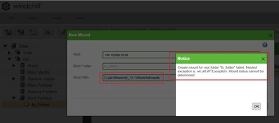

Hi All,
Im trying to configure replication server and whille adding root path im getting this error
Create mount for root folder "fs_folder" failed. Nested exception is: wt.util.WTException: Mount status cannot
be determined
BR
Sarathkumar M

Jan 4, 2025 4:51 PM UTC
Article - "Mounting folder on Replica site fails with error "Create mount for root folder <foldername>" in Windchill PDMLink": https://www.ptc.com/en/support/article/CS96782
VladimirN24-Ruby IVAnswer
