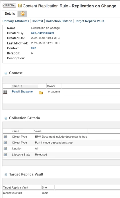

I tried it out but somehow it doesnt do what i want....i want only the released cad dokuments to be put in replica vault my Rule looks like this:

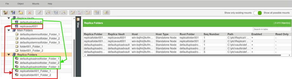

and when i start the scheduler the the released documents should be in the replicavault001 in the folder replicafolder001 like in the picture below
But they end up in the defaultuploadvault (cache vault) am I missing something?

Nov 19, 2024 11:02 AM UTC
Has the replication job successfully run? Because cache vault is not the final location , its a system side location before the actual replication completion.
Please check this.
Cheers
Hari
