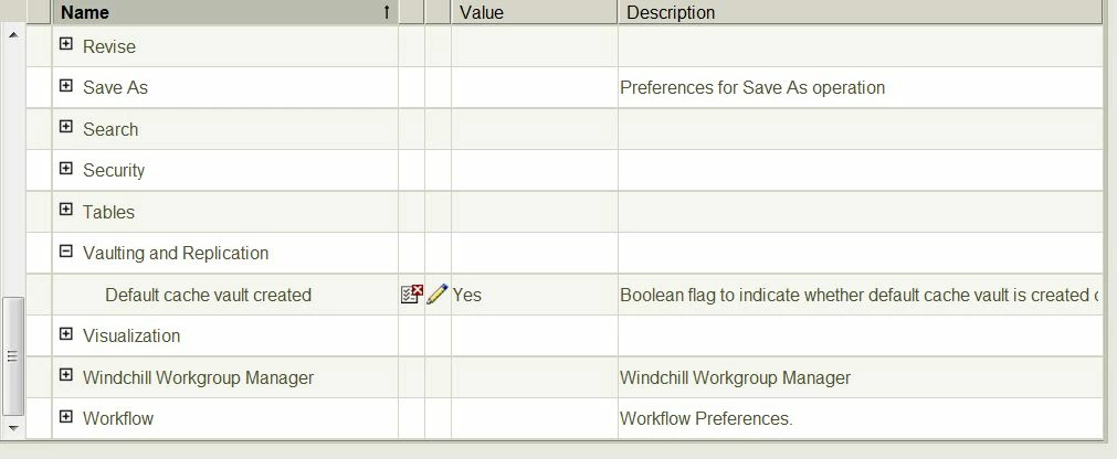

Replication is setup and working I have created a cache vault on the replication
I do not see the option to set the cache to the replication server for my remote site. What do I have to turn on or set to let users select something other than the master server?
Jun 27, 2011 5:46 AM UTC
Each user has to define it into their preferences:
Home > Utilities > Preference Manager > Vaulting and Replication > Preferred File Server
