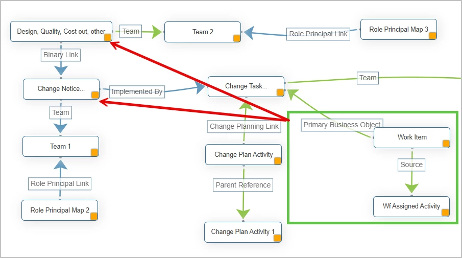

Hello all,
I am currently working on a complex Report for ECR system. I have made a great progress by studying other threads and also found some QML´s. However I am now stuck in and I would need your advice.
I was able to create a report able to track data in ECR, ECN + DT and examine complexity, how long it took (by calculation), etc.
My trouble is to track activities in different objects. I was able to create a connection Change Activity → (Primary Business Object) → WORK ITEM → (Source) → WF Assigned Activity, that will report activities I needed however only for one of the Objects, but when I connect WORK ITEM with (Primary Business Object) to any other Object (ECN, ECR) I get no results.
Can you advice what should I to to get activities from all of the types in single report?
Thank you in advance.

I didn’t quite follow. What are you trying to report on that you’re unable to report?

Hi Joe,
Thank you for reaching out. Sorry for not fully explaining my issue.

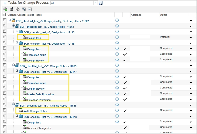

I want to be able to Report Activity (Task) in each of the levels of ECR, therefore Design task, Change Notice and Change Request. Hope that attached picture would help to understand.
