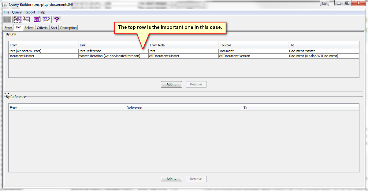

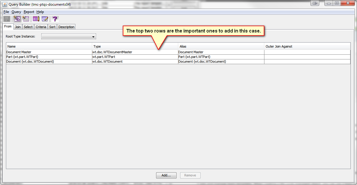

18-Opal
Mar 28, 2016 7:22 PM UTC
Thanks Binesh!   That put me on the right track.
Here are the From statements I ended up with:
...and here is the join.
