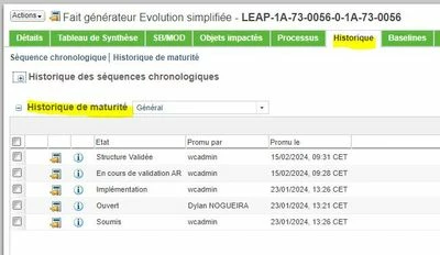

report builder model creation (Windchill 11)
hello
i  would like to add object history into selection/constraint ?
Ex : Change History
Regards

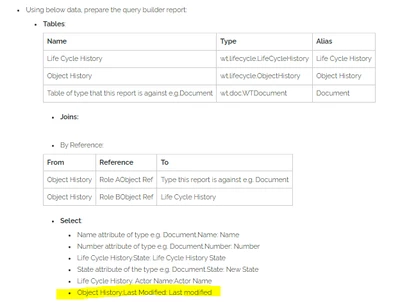

Mar 14, 2024 2:22 PM UTC
Please can you change the browser language to English, because it is impossible for you not to have the last modification date since it is a STANDARD attribute of Windchill.
Then, having done that, verify that the table you put in the report is the correct one.
In my case it has this internal name wt.lifecycle.ObjectHistory
Having done that I wouldn't know what else to suggest.
Marco

MarcoTosin
Mar 7, 2024 9:09 AM UTC
Take a look at this article
How to generate a report to display the Maturity History of an object
Marco
Mar 13, 2024 9:21 AM UTC
Hello Marco
I suppose, i have not selected the good attribute
but i have not found an attribute named « promoted date »
please see attachments
Regards
MarcoTosin
Mar 13, 2024 9:34 AM UTC
You have selected the state not the date.
Try the attribute highlighted in yellow
Marco
