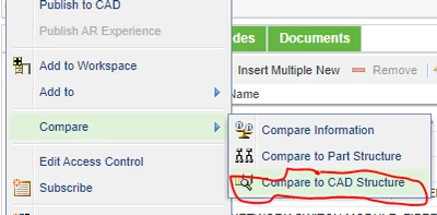

@AN_10714372 When you are looking at the 'gear' assembly, open the Actions menu:
I think you need to have an Owner link between the CAD assembly and the gear.
