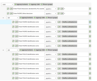

Version: Windchill 11.2
Use Case: I try to extract the list of all views with Alternative Boms.
Description:
Setting the criteria in the sub-set I'm not able to View the Alternative Bom with and without the Alternate Bom value on the same report.
Some info is always missed.
Any idea?

When you use sub select in reference to views, if you have more than one view you MUST create them for each view.
In the case of BOMs the same thing applies to child codes as well as to parent codes (see image).
