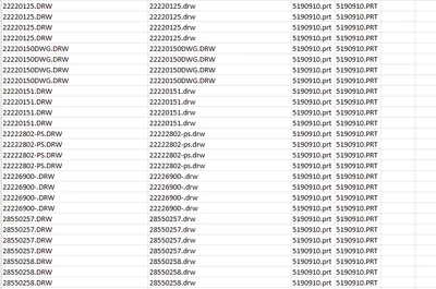

Use Case: I am trying to generate a report for all the drawings that reference a part/assembly in windchill.
Description:
I have attached the qml I used which seems to generate a report with multiples of the same drawing reference for a given part instead of just one (pictured below). I thought setting the criteria for Cad Document.Latest Iteration equal to 1 would return the referenced by data for only the latest iteration.
MarcoTosin
Feb 6, 2025 7:25 AM UTC
It is not enough to select last iteration because this selection extracts ALL the last iterations of each individual Revision.
To select only the very last you have to use a fairly complicated system that is explained in this article.
Report of the latest version of all drawings at any State
You can start with the QML file attached to above article and then add the tables for references as explained in this other
How to create a Query Builder Report to get all CAD references of a Drawing in Windchill PDMLink
