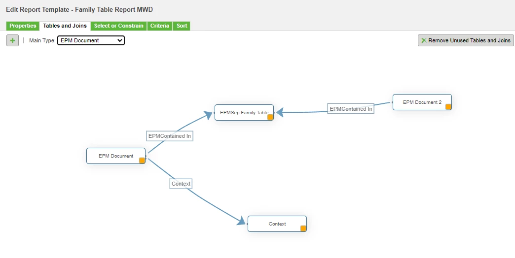

Report that references EPM Document Sub Type to get the Sub Type Attributes
I found a report here... but need to get it to give me an attribute from the EPM doc sub type.  Our Sub type is called CAD Document.
This is all to spit out a full family table with the CAD Document Attributes.  These attributes don't exist in the EPM Doc parent type

Dec 13, 2022 8:01 AM UTC
Hi @ChiselnMallet1
In the report builder you need to change the type of object from EPMDocument to subtype object CAD Document.
PetrH
Dec 13, 2022 1:28 PM UTC
Good Morning...
Should have mentioned that I tried that.  Seems that when I use the EPM Document I get 500 result, as there are 500 members.  When I use CAD Document I get over 2000... for each member it returns itself, it's nested parent and the Generic.  Not sure why... I'd like it to be clean so I don't have to figure out how to filter or massage the results after
