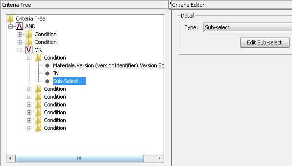

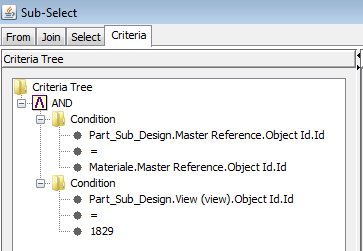

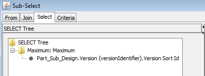

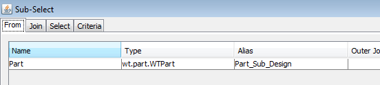

First of all it's necessary to add an OR condition in criteria, and relative sub-select, for each view (7 in my case).
Then in sub-select you must add criteria to have the latest for each view, in the same way that you work to get the latest version of a WTPart.

I've got the solution from Marco Ferrari‌.
