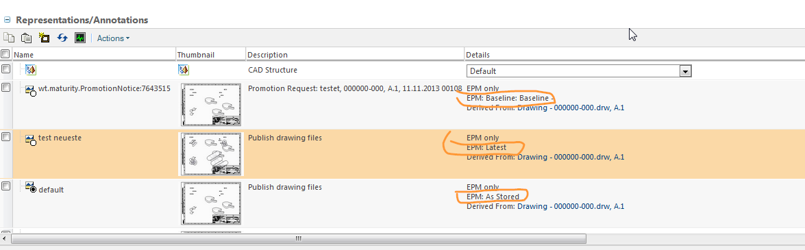

I was able to make a report that lists the representations with their CadDocument. Interestingly there is also a hint on this as CS191374 - but this only explains how to list the representations with their linked epmdocuments.
But now I want to also list the configspec that the representation uses. Since it is also displayed in the table of the representations I thought there would be an easy way... but I didnt find any attributes that I could get to display those values...
There is even one that sounds good: Derived Image.Derived From Config Spec - but I could not get any values of that...
Maybe I did something wrong, did anybody come across a way how to get the configspec out of there?
