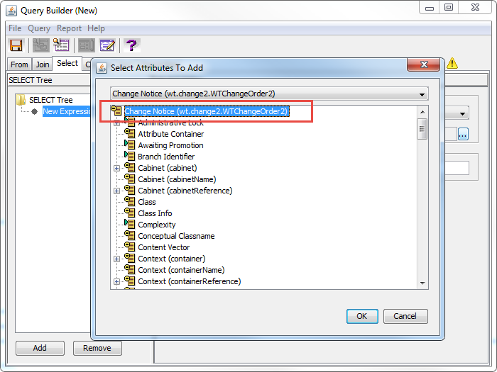

Reports/QueryBuilder - What to SELECT to get a hyperlinked Attribute
I'm trying to get my report to display Hyperlink for Number of Name similar to the behaviour in Table displays. Change Objects such as Change request or Change Notice...
Is there another data type that I should be joining on?

Feb 19, 2015 7:30 PM UTC
Keir,
The top level object, such as the screenshot below.
Please mark as answered if this is what you're looking for.
BenPerry
BenPerry15-MoonstoneAnswer
Keir,

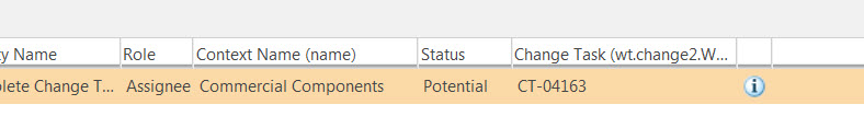

Feb 19, 2015 9:36 PM UTC
Thanks @Ben!
Not exactly what I was looking for... The "Info" Icon will do the trick but I was hoping to get the number CT-04163 as the familiar to Users blue hyperlink
BenPerry
Feb 20, 2015 1:17 AM UTC
I hear you. I have the same grumble. It worked like you wished in 9. But now in Windchill 10 it's just text with an info icon.
