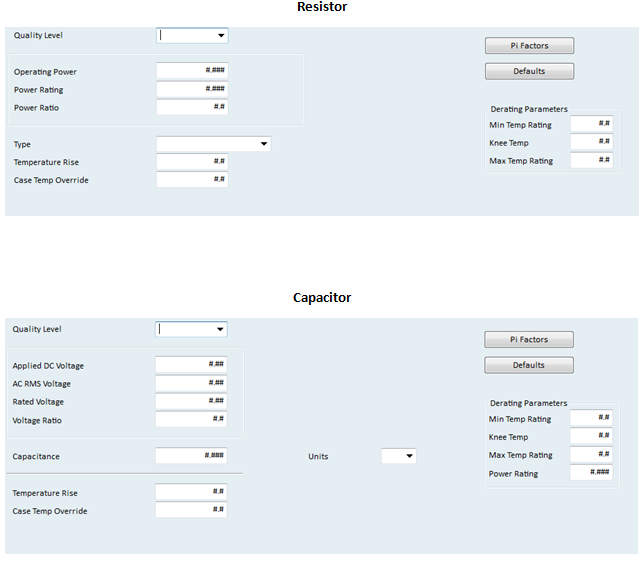

Hello Experts,
We are having difficulty to fill some parametrs in part information that will be used in Part Stress Analysis in Windchill Quality Solutions Prediction module in accordance with MIL-HDBK-217F.
For example when we add a part into library it is asking information for parameters as you can see below picture, but we do not have enough experince. We read the Practitioner's Guide and we note that the meant of the all data of the part but we don't discriminate between which one related the circuit operating value and which one related the component base.

Funda,
As a novice, don't think too much of such details.
Fill in what you can and leave the rest empty. Relex uses sensible defaults.
Complete your first project, build a parts library from your completed project, and then see how Relex handled all the data. In its default settings, Relex (almost) pulls only those parameters into the library that are independent from circuit details.
