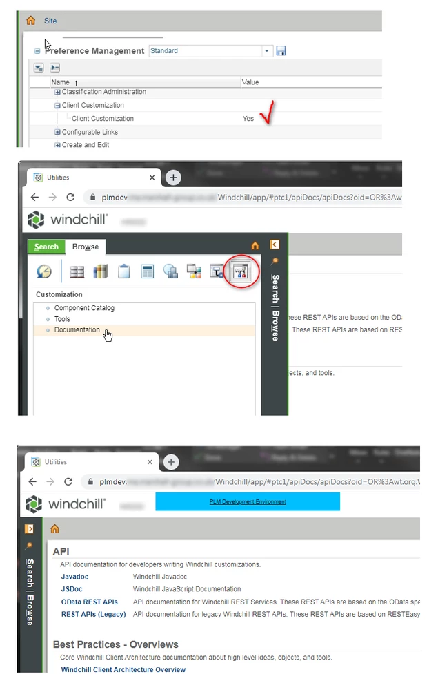

HI @NS_8621206
There's other places to view the docs but I like the documentation viewer in the Windchill UI.
For the Odata REST APIs there's a nice swagger-like try it out feature.

            Thanks for the reply, I have already explored both rest api docs but no where found api for action on workspace. I can see there is apis available for get and create folder but not for workspace.
I have seen some code in Javadoc (wt.epm.workspaces), but i wanted to know whether rest apis are available for creating and getting details of workspace.
