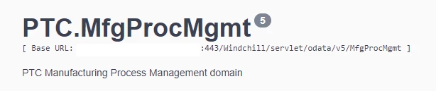

REST API to get Manufacturing Process plan details and associated operations and parts
I am using Windchill MPMLink Release 12.1 and Datecode with CPS 12.1.2.1
Need REST API to get Manufacturing Process plan details.
Our requirement is to get all associated operations and its related parts.
Here are the errors that I faced

Hi @AS_10652879
Check PTC Manufacturing Process Management Domain, all APIs what you need are there

Hello AS_10652879,
Can you review Windchill Help Center > PTC Manufacturing Process Management Domain ?
Also kb article CS404200.
