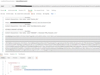

I then create a stage 2 request following the guidelines in the rest document
POST https://replicaurlBaseAddressHere/Windchill/servlet/WindchillGW/wt.fv.uploadtocache.DoUploadToCache_Server/doUploadToChache_Replica?mk=wt.fv.uploadtocache.DoUploadToCache_Server&VaultId=1027696&FolderId=495134041&CheckSum=55879253&sT=1549994693&sign=q8pdvh4fy1dCM7srwl3%2BOwH2W0Wti7AEpgS2xpfdgHZMpHsTze1WPl2OiB%2FG3FyLPqJCU%2BBkjdbxXuX5IiE4Bw%3D%3D&site=https%3A%2F%2Fbasewindchilladdres.com%2FWindchill%2Fservlet%2FWindchillGW&AUTH_CODE=RSA&isProxy=true&delegate=wt.fv.uploadtocache.DefaultRestFormGeneratorDelegate HTTP/1.1
Accept: application/xml
Authorization: Basic basicauthhash
CSRF_NONCE: FFYxrn635KI1zhh0VyJmx0bN1OttoGAbYzweyD35ipN2mVwGfG5r1wSAi89hoC5HUGZFxgj9sZ8P/y1ALW8ImkiO1JsD/CI5Pz90gRfPtvJwgHEMc2IIlzyGhpt08yU=
Content-Type: multipart/form-data; boundary="-----------------------------boundary"
Host: replicaURLServerHostNameHere
Content-Length: 3027
Expect: 100-continue
-------------------------------boundary
Content-Type: text/plain; charset=utf-8
Content-Disposition: form-data; name=Master_URL
https://BaseWindchillurl.com/Windchill/servlet/WindchillGW
Content-Disposition: form-data; name=CacheDescriptor_array
26646757:29232496:26646757
Content-Disposition: form-data; name=26646757; filename=config.da0; filename*=utf-8''config.da0
[CFG]
config last_saved "16:06:16, 08 Feb 2019"
...file contents here ...
[ENDCFG]
-------------------------------boundary--
This then is sent, and it "works" as in there is no error, but it returns an empty contentInfos structure:
HTTP/1.1 200 200
Date: Tue, 12 Feb 2019 18:04:56 GMT
Server: Apache/2.4.25 (Win64) mod_jk/1.2.42 OpenSSL/1.0.2k
X-Ptc-Connected: 1
X-Frame-Options: ALLOW-FROM https://windchillbaseurl.com
X-do-not-compress-this: 1
Vary: Accept-Encoding,User-Agent
access-control-allow-origin: https://windchillbaseurl.com
access-control-allow-credentials: true
expires: Thu, 01 Jan 1970 00:00:00 GMT
Content-Length: 19
Content-Type: text/json;charset=UTF-8
{"contentInfos":[]}

Jun 6, 2019 2:50 PM UTC
@jlpatte2 It looked like your stage 2 Header has below. Please remove it and that should work
Please refer to this document Windchill REST Services 1.5 User's Guide (page 173)
NOTE: If you are using Postman, make sure you are using the latest version or the chrome extension (deprecated)
The rest looks something like
POST <Upload URL from stage 1>
CSRF_NONCE: <CSRF_NONCE>
Content-Type: multipart/form-data; boundary=----WebKitFormBoundary7MA4YWxkTrZu0gW
------WebKitFormBoundary7MA4YWxkTrZu0gW
Content-Disposition: form-data; name="Master_URL"
http://amarsingh2v2k16.ptcnet.ptc.com/Windchill/servlet/WindchillGW
Content-Disposition: form-data; name="CacheDescriptor_array"
12001:12001:12001;14011:14011:14011;14012:14012:14012;
Content-Disposition: form-data; name="12001"; filename="file1.txt"
Content-Disposition: form-data; name="14011"; filename="file2.txt"
Content-Disposition: form-data; name="14012"; filename="file3.txt"
------WebKitFormBoundary7MA4YWxkTrZu0gW--
