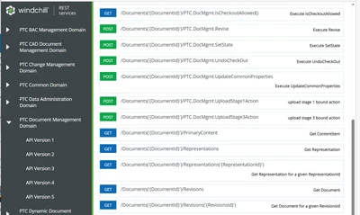

Based on the current REST API I was able to upload primary content following some examples using the uploadstage1action and uploadstage3action. However, my use case is to provide an integration that allows to update the primary content. Clearly this can be done easily via the web UI.
There is no obvious method using the REST API. Using the example on a document which already has primary content the uploadstage3action fails with indication that a document cannot have more than 1 primary content.
There are no methods to delete the current primary content, nor to update (PUT/PATCH methods).
This seems like a very normal use case for an integration, and I'm wondering what I'm missing here.
I'm testing with windchill 12, WRS Document Management Domain, API Version 5

I'm building an external tool that communicates with Windchill 12 using the ODATA REST API.
This REST API and specifically PTC Document Management Domain API Version 5 provides endpoints for all sorts of actions on documents, including setting and retrieving primary content.
There are several examples on how the upload content (primary/attachments), which I have followed and am able to upload primary content for a document that has not yet primary content. However when the WTDocument already has primary content this method of upload fails, with a message that primary content already exists.
There is no endpoint identified in the documentation that describes how to remove existing primary content, or otherwise prepare for a new upload. Clearly updating primary content via the Windchill web interface is no problem and very easy to do.

Any luck in solving this? I am running into the same issue on Windchill v12.1.2.4. I am just a user, not an admin of our Windchill instance. I need to be able to update primary document content programmatically via the REST API. Currently this is failing with the message `{"error":{"code":null,"message":"Can not add more than one primary content to the object."}}` when hitting the endpoint `Windchill/servlet/odata/DocMgmt/Documents('<OID>')/PTC.DocMgmt.UploadStage3Action`.

It does not appear in the Windchill REST API Documentation page, but you can delete primary content using this endpoint. Then you can attach the new primary content.
DELETE /Windchill/servlet/odata/v5/DocMgmt/Documents('OR:wt.doc.WTDocument:XXXX')/PrimaryContent
See Article - CS290268 - Is it possible to use Windchill REST Services to replace Primary Content for a WTDocument in Windchill Solutions?
