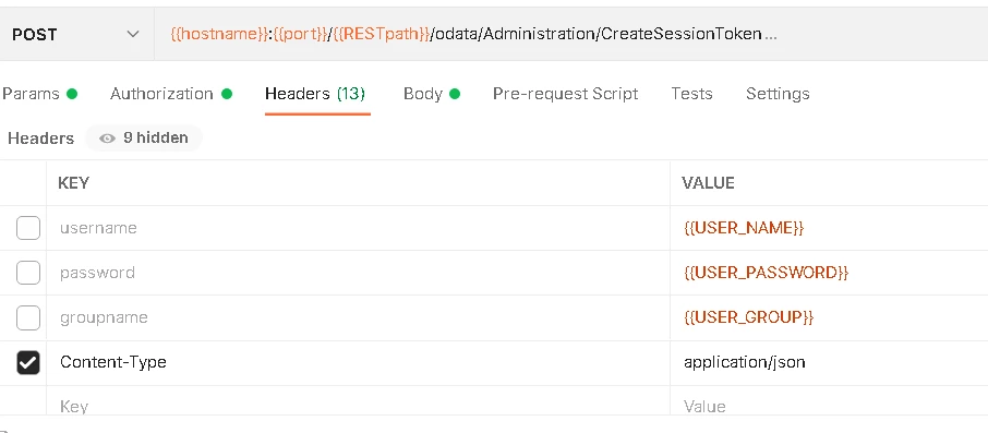

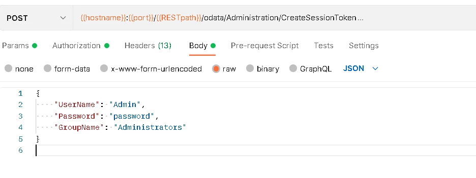

REST api with odata failed
trying to call this rest api with POST  http://windchill25/WindchillRiskAndReliability13.1-REST/odata/Administration/CreateSessionToken
i’m getting
    "error": {
        "code": "FailedToAuthenticate",
        "message": "Login Authorization failed"
In the Header i did add UserName, Password and GroupName.
This rest api work fine
http://windchill25/WindchillRiskAndReliability13.1/dataengine.asmx/GetSessionToken
Any suggestion to debug this failure. (username and password are correct)

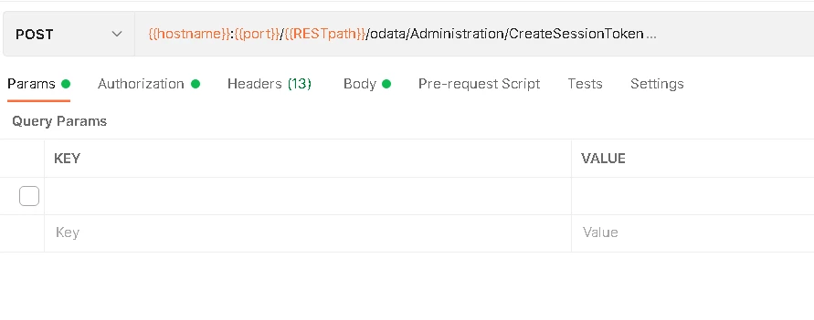

BryanKAnswer
Oct 1, 2026 9:48 PM UTC
Try this in postman.
