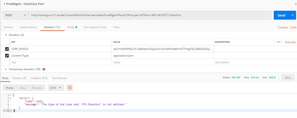

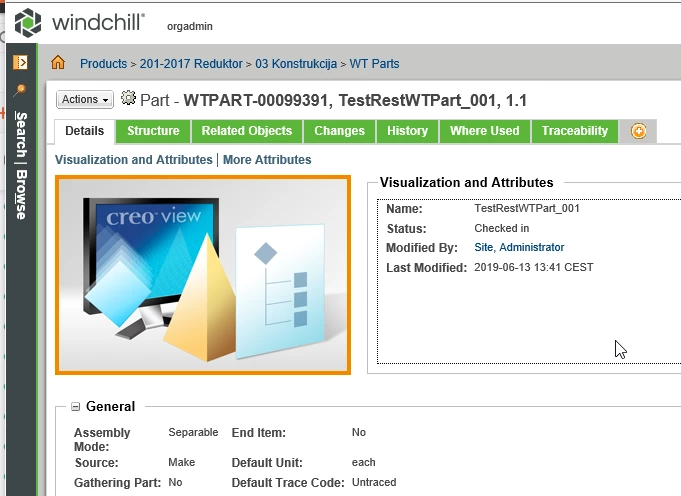

I created new WTPart and tried to do Checkout via REST call, someting like that:
http://tomazj-wnc11.audax2.local/Windchill/servlet/odata/ProdMgmt/Parts('OR:wt.part.WTPart:1462146')/PTC.CheckOut
Exactly like in Windchill REST Services User’s Guide v1.5, page 167.
I used POST call, I got current CSRF_NONCE.
Return JSON is :
"error": {
"code": null,
"message": "The type of the type cast 'PTC.CheckOut' is not defined."

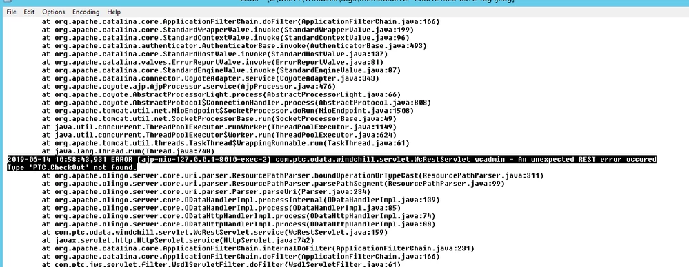

MS log error is:
2019-06-14 10:58:43,931 ERROR [ajp-nio-127.0.0.1-8010-exec-2] com.ptc.odata.windchill.servlet.WcRestServlet wcadmin - An unexpected REST error occured
Type 'PTC.CheckOut' not found.
