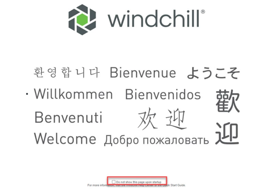

Restoring the Windchill Welcome Screen - Is it possible?
Version: Windchill 12.1
Use Case: Hi, Is it possible to restore the welcome screen shown in the screen shot, After a user checked the red marked box? I could not find any helpful article to reset it. There is no such a thing the preference management of the user. Is it possible to delete a cache or something for a particular user? I have admin credentials too.. This request is not urgent for sure, but one of the users asked me to help him with it.. Thanks for your help

Sep 26, 2024 12:53 PM UTC
The checkbox was removed after version 11.
https://www.ptc.com/en/support/article/CS292318
It looks like they purposely removed it. Steps from @mmeadows-3 might be more than you are looking for but if the user wants to see it, he correctly shows where it is in the QuickLinks. I am not sure you want to customize this to enable for all.
Sep 25, 2024 5:25 PM UTC
Probably more than you care to know about the Welcome page...
https://www.ptc.com/en/support/article/CS194286
%wt_home%\codebase\netmarkets\jsp\netmarkets\welcome.jsp
Notes:
  • This page (and the check box) can be accessed by: QuickLinks > Help > Welcome to Windchill
  • %wt_home%\codebase\netmarkets\jsp\netmarkets\welcomepage.jsp is for earlier releases.
https://www.ptc.com/en/support/article/CS58708
  • The page can be turned off for everyone using loadFromFile.
https://www.ptc.com/en/support/article/CS67176

Where csvvalue:
  1. b%3A0 - The Welcome Page is displayed for every user.
  2. b%3A1 - The Welcome Page is not displayed at all.
windchill wt.load.LoadFromFile -d filename.xml
  • The preference can be deleted too.
https://www.ptc.com/en/support/article/CS258377
Sep 26, 2024 1:35 PM UTC
Thank you so much for your kind research! That helped.
