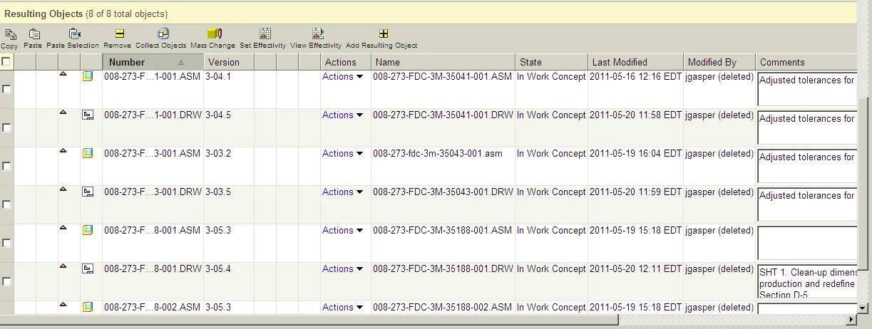

Hi all,
I have been working with Query builder to create a report that shows the comments for each of the affected and resulting objects on a change task. I have been able to get the comments of the change task just not the comments for the affected and resulting objects. Each affected or resulting object can have its own comments. We use these comments all the time but I have not been able to find them in QB. See the attached image. The comments I want are on the right side of the image. Any help would be greatly appreciated.
Brian

The comments are likely an attribute of the link object.
Instead of just linking the WTChangeActivity2 to the changeable, you will
want to join the WTChangeActivity2 to the link class, and then join the
link class to the changeable. To do this, start by adding the link class
to the From tab, so that you have 3 classes in the from tab instead of 2.
You can look up with side of the link is for which class in the UML
diagram, or you can guess with trial and error. Once you do that, then
you can pick attributes off of the link object, itself, in your display.
I have not tried this yet, but it is a good guess. Let me know if it
doesn't work, and I'll dig into it deeper to figure it out and send an
example.
Al Anderson
