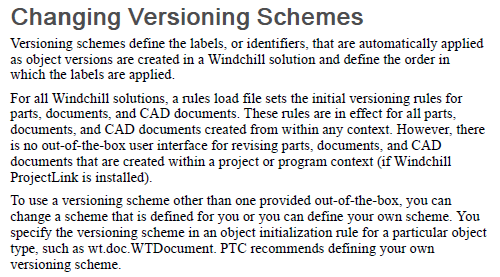

I think the series is referenced in your OIR. Let me see if I can find it...
TomU
Dec 19, 2014 4:30 PM UTC
Yeah, whatever custom versioning scheme you were using on 9.1 needs to be loaded into 10.2.

Fully documented in the Specialized Administration Guide

Brian, run this command from a Windchill shell to extract your current series: (change path as necessary)
java wt.series.LoadFileBasedSeries E:\PTC\Windchill_10.2\series.xml -read
Then on your 10.2 system, run this command to load it back in:
java wt.series.LoadFileBasedSeries E:\PTC\Windchill_10.2\series.xml -load
