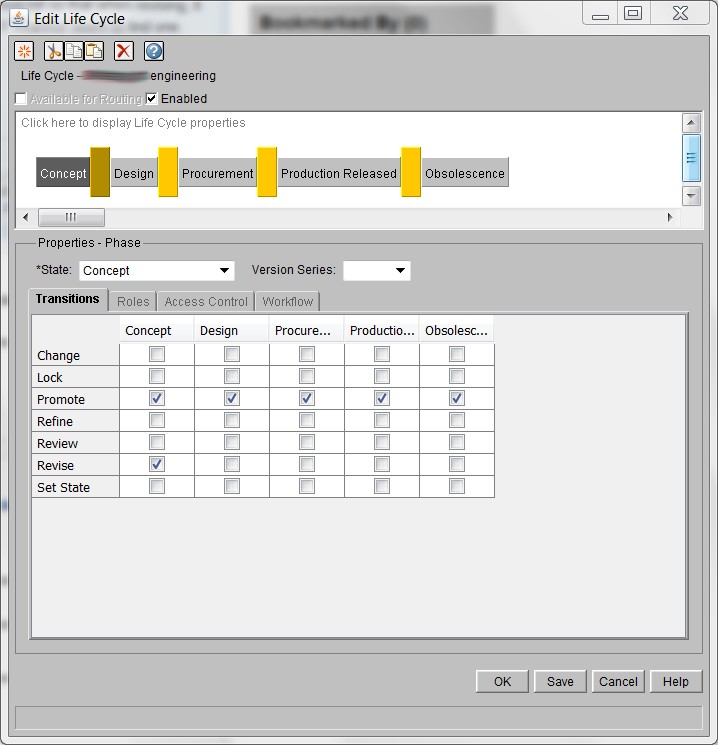

Hi everyone,
We are using Windchill 10.0 M030
Whenever our designers revise a part, WTpart, or .dwg (ex A to B), Windchill automatically kicks the file's Lifecycle State back to "In Work" on the default template. We created our own custom template with the appropriate States, but this glitch is also even happening on test parts using the default template. Every time a part or dwg gets a revision, we have to reset the state for each file.
We haven't gotten the managerial PLM features integrated into company procedures yet, so for now this is just an annoyance for designers using Windchill. However, as we move forward, this could cause some serious problems and confusion.
Is there a preference somewhere to configure Windchill so that when revising, it maintains the same Lifecycle state and template? I cannot seem to find one.

Lifecycle transition for REVISE at the current state is set to go to INWORK? Please check at transition tab for this lifecycle.
Aug 16, 2012 12:51 PM UTC
This is what the Transition tab looks like for each state of the lifecycle, but I'm not sure exactly what the effect of these checkboxes are:

Aug 16, 2012 4:44 PM UTC
Jon,
WHen the REVISE occurs you want to stay on the same lifecycle state. In your screen shot, when you are revising in CONCEPT state, the part will remain at the CONCEPT state.
Similar way you should check the transitions on other states, just set the Transitions REVISE checkmark for the SAME state. That will solve your problem.

Aug 16, 2012 5:57 PM UTC
Thanks for the tip Preeti, but unfortunately this did not change the behaviour.
After checking these boxes appropriately for each state, the revise command does indeed keep the same state in the "new state" field of the confirmation dialogue box. However, once you press OK, the part reverts to the Basic Lifecycle template again, in the "In Work" state.
The problem persists, as every time we revise an object, we must reselect its lifecycle template and state.

The system automatically assigns the latest Iteration of the applicable lifecycle on Revise (aka New Revision).

Aug 21, 2012 1:21 PM UTC
Thank you everyone for your help,
I did end up achieving the behaviour that I needed, but I would like to clarify how:
Upon revise, the Lifecycle would revert back to the Basic template, regardless of how I configured it. So to solve the issue once and for all, I went to the Site level and edited the Basic template. I changed the States and added checkmarks for the Revise transition of each state, with each checkbox the same as its state. This is only possible at the Site level utilities.
We will change all parts on our server to the Basic template, and everything should be good from here on out.
