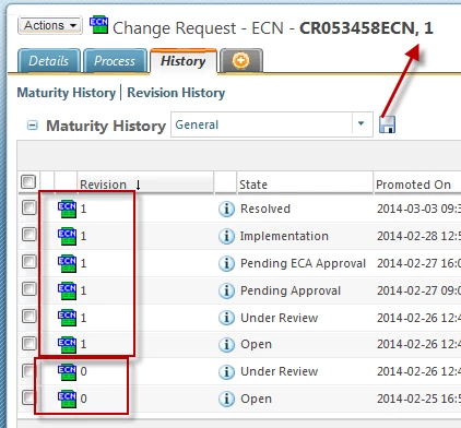

We have the this preference set to Yes. We've done close to 30,000 changes this way.
[cid:image001.png@01CF385B.F63CC1B0]
Primary business requirement: Clean approval report once the change has finally been edited such that all can approve (we route for approval rather than having a change admin enter what all agree in meetings). If you do not revise the change object and it needs to be edited and reapproved, there are multiple approval records for the same person on the same change.
Example
[cid:image002.png@01CF385C.4B2ADA40]
