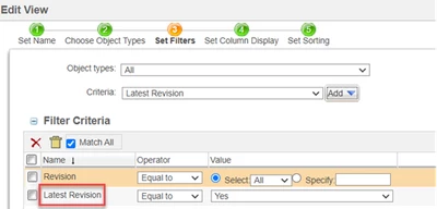

When you edit a view in Folder Contents of a product you can customize a view and enter these criteria:
For context I was having similar issue in this article: https://www.ptc.com/en/support/article/CS370354
And the image above was taken from there. Can anyone explain why would I want to set Revision to All and Latest Revision to Yes? Does the first criteria even serve a purpose? When I delete it it doesn't make a difference.

Yes. We need to only display the latest version of manufacturing and design parts. The solution in PTC article wants to set "Revision = All" and "Latest Revision = Yes", which doesn't make sense.
I also noticed that if you remove all filters, then parts will be displayed correctly - latest versions of each view. This also does not make sense.

I have noticed that in the PTC article when you set the "Revision = All" and "Latest Revision = Yes" if there are Subfolders they are not visible.  Our current view is set as "Revision = Latest".  If I remove this filter to show all the Service views, will this cause other Folder view issues?
