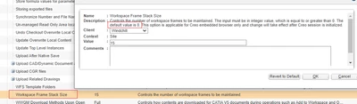

Hi @DCG
It is possible just only if you have set preference Workspace Frame Stack Size
Default is zero.
Then you can go back rollback last numbers of saves.
PetrH
