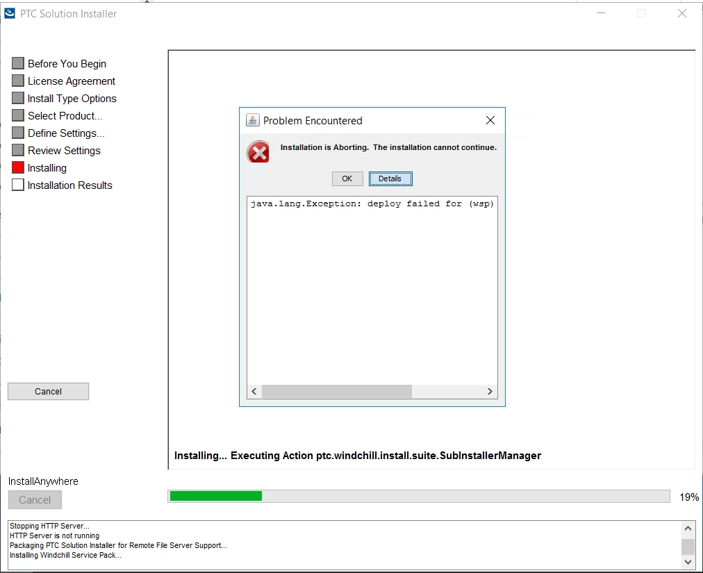

Running CPS on Rehosted Test Windchill(11.1 M020 CPS 27) failing
Running CPS on Rehosted Test Windchill failing with error
INFO 2024-10-16 09:58:29 - BUILD FAILED
INFO 2024-10-16 09:58:29 - D:\ptc\Windchill_Apps\Windchill\bin\installModules.xml:672: The following error occurred while executing this line:
INFO 2024-10-16 09:58:29 - D:\ptc\Windchill_Apps\Windchill\bin\ptcarchive.xml:85: Repository windchill-test.marine.net.int does not exist
INFO 2024-10-16 09:58:29 - at com.infoengine.administration.packaging.AntInstaller.execute(AntInstaller.java:225)
INFO 2024-10-16 09:58:29 - at com.infoengine.administration.packaging.AntInstaller.execute(AntInstaller.java:175)

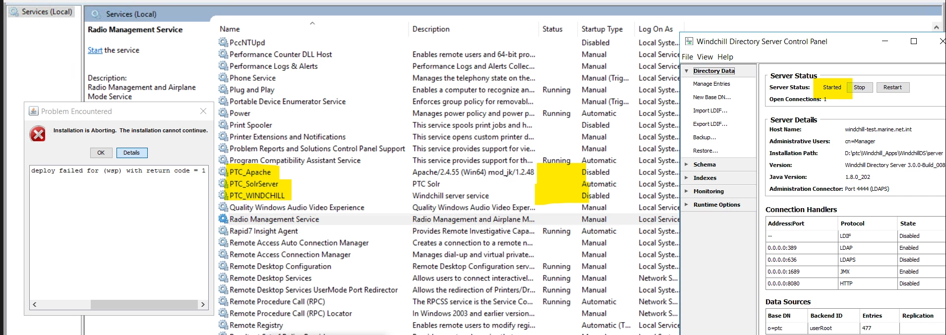

Oct 23, 2024 12:12 PM UTC
Dear PTC community
Added Further details for Some of the Windchill Property files.
Kindly assist.

Without digging in too deep, this might be a case for a PTC Tech support ticket. Be careful sharing such detail information of your environment. This site is public. Let's start with some basics. You mentioned this server is a rehosted instance. Did the rehost work? Does it function without issues prior to you trying to apply the CPS? The line about the repository being missing might be pointing to a misconfiguration from rehost. Is "windchill-test.marine.net.int" from Production or the test server?
Oct 23, 2024 6:11 PM UTC
Hello @avillanueva yes i Raised the Ticket with PTC but PTC tech Support said the Windchill version is out of Sustainable support project and they want assist on it. and Suggested to reach out to PTC community for assistance.
Yes the Windchill is Still up and Running. And Windchill-test.marine.net.int is from Test Server.
