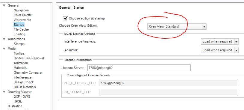

Running Creo View Standard vs. Creo View Lite....can I run standard when not connected to network?
When I am connected to our network, I can run Creo View Standard because it grabs a license.
The question ....... is there a way to run Creo View Standard when not connected to our network, such as a stand a lone?
Mar 8, 2016 11:34 AM UTC
Hi
Yes this is possible, if you have a license txt file, the install will install FlexLM server on you local machine which will act lik the one you have in you network. you can install it manually and use 7788@localhost as license server.
